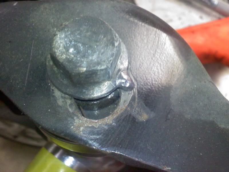

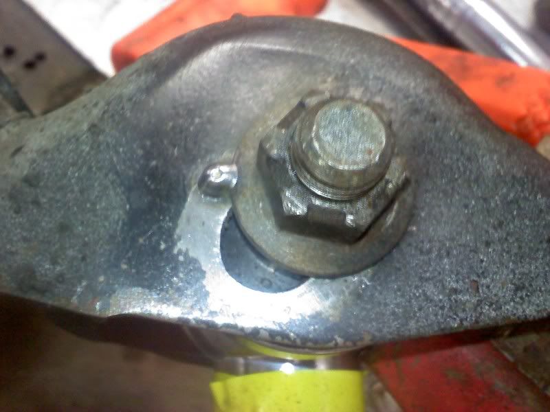

I just did a full suspension swap on a customer's car.. replaced all suspension with new OEM shocks, RSR springs, FUCA,RUCA, tension rods etc.
His FUCA brackets were slotted from a previous alignment shop to allow for more adjustment.
I placed them back to where the stock location would be and tack welded the nuts to the bracket to lock them in place.
